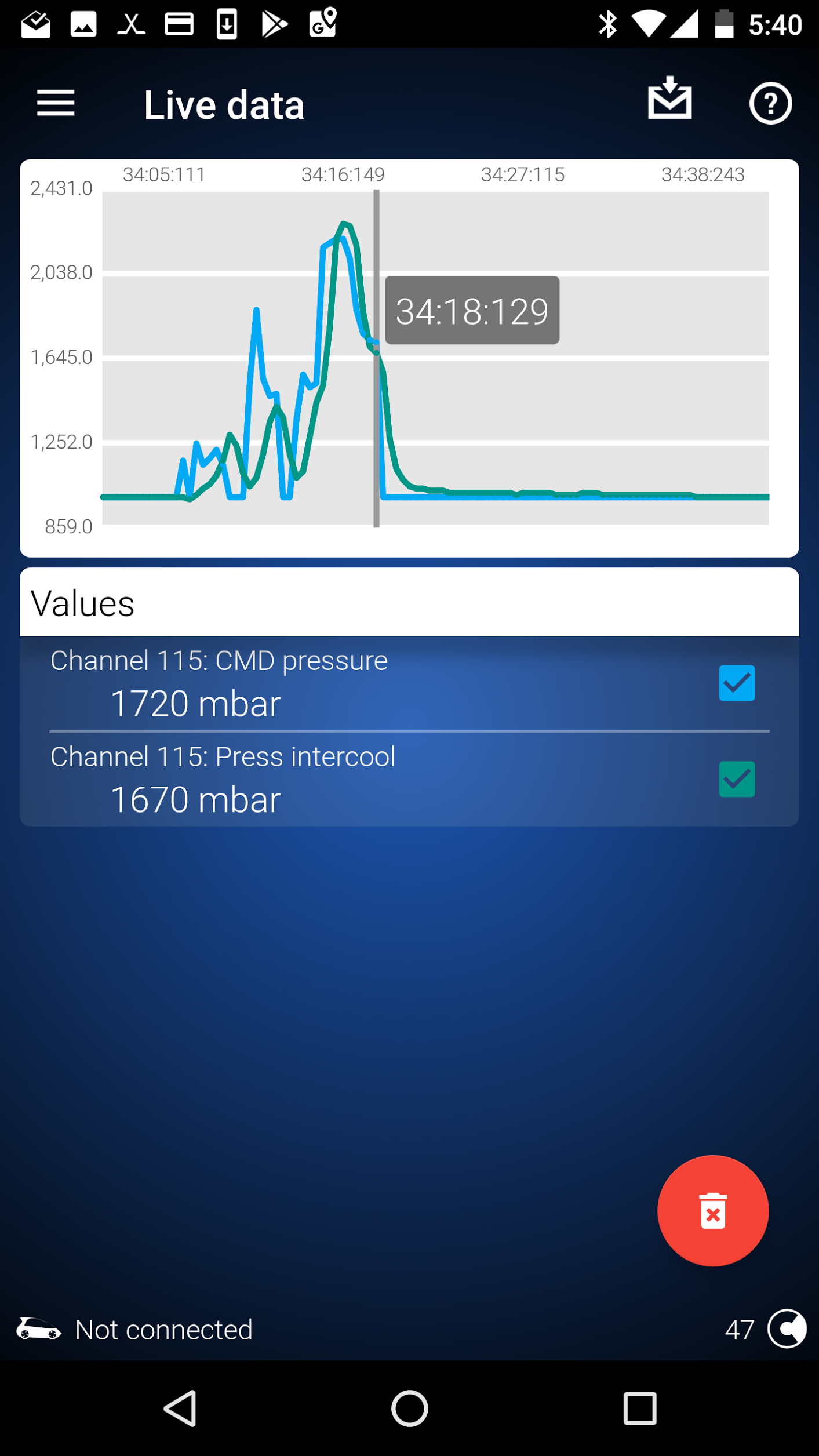

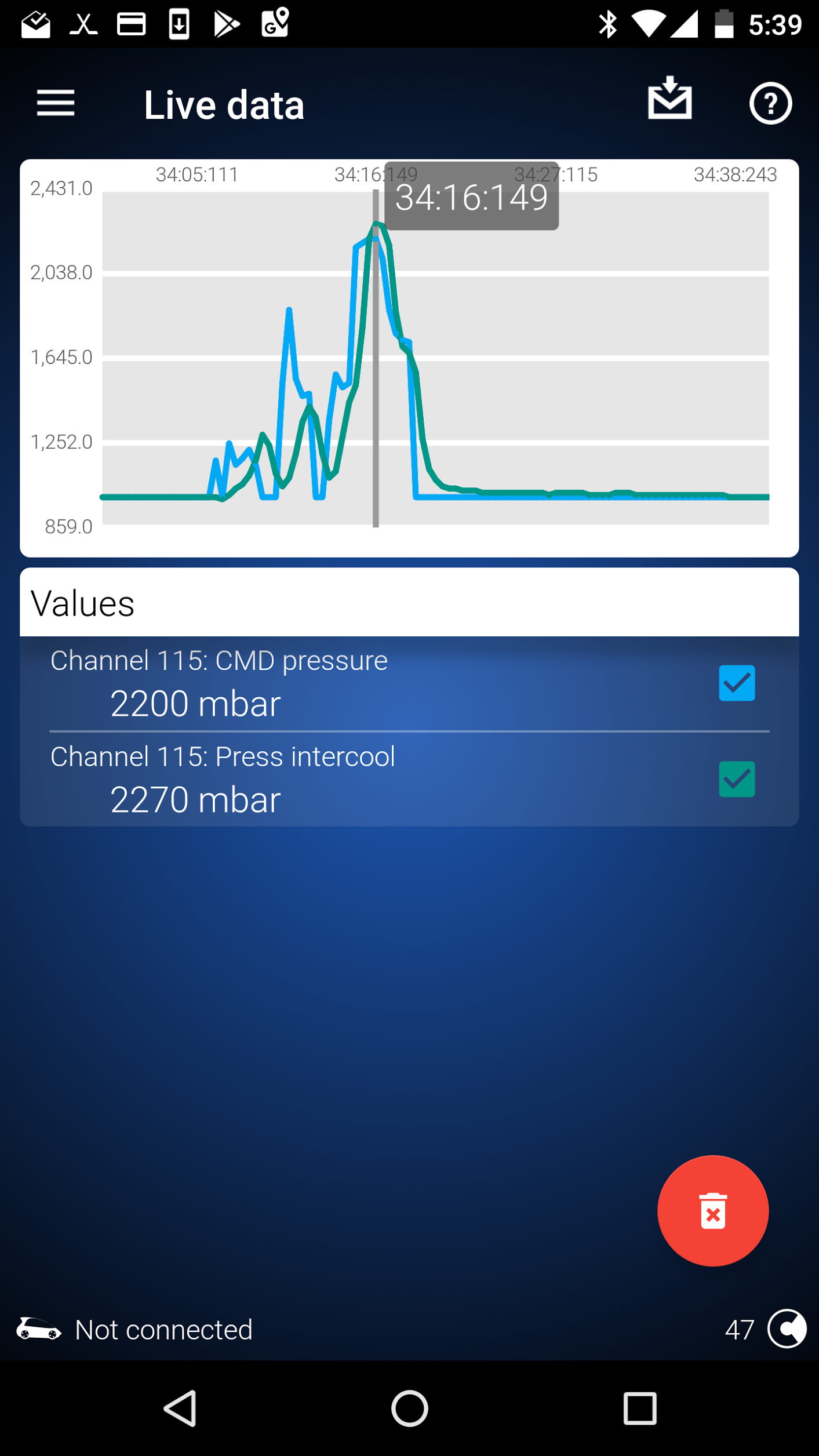

My problem is that my boost falls off when accelerating at wide open throttle. Naturally, I monitored the boost using my OBDEleven (both requested and actual boost) expecting to see the actual boost falling with the requested boost staying normal, but no! I hit solid boost at around 3000RPM, but by 4000RPM the boost drops from 17-18 psi to 8-10. It is especially noticeable at higher gears, when I try to accelerate in 5th or 6th gear. If I apply partial throttle, it will accelerate faster. At WOT it falls flat on its face. Basically the car has good power from 3k to 4k, then feels much slower. I can actually hear the waste gate dump boost when I hit 4K rpm. Here's a couple screenshots to show you.
This is about 5 seconds of full throttle in 3rd gear (the bit between the 2 readings I show). Starting off it looks good to me. Requested boost peaks at about 18psi, with the actual boost catching up relatively quickly. But then, requested boost falls off and settles back down at around 8-10 psi. This is shown on the 2nd screen shot. The hard falloff afterwards is me lifting off the throttle.
Honestly I'm not sure what to think. At this point I am wondering about metering the MAF to see if the airflow becomes restricted when WOT (collapsing air intake perhaps? Was that ever a real issue?) I haven't logged misfires yet, but since the plugs and coils are new, and I can't hear any engine weirdness, I don't think that's it.

Boost leak under full load. Need to do a pressure test. Use higher pressure similar to what the turbo puts out. Or, inspect the big fat rubber hoses for tears/loose clamps.
Also a chance the actuator on the turbor is not working correctly for some reason. Or, wor$t case, the turbocharger is reaching the end of its' life. https://www.turbobygarrett.com/turbobygarrett/
