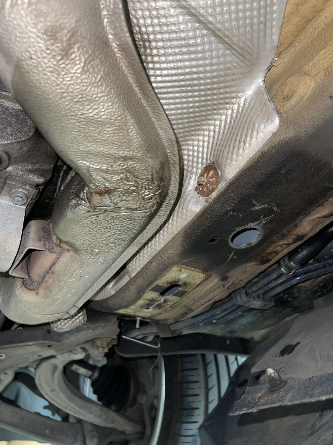

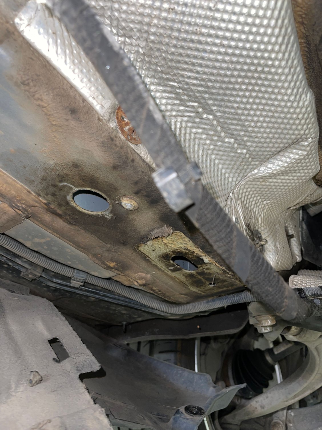

Guys in this thread thank you very very much, this “tpi fix” done the job for me, all the stress and headache from the past 10 months of creaking and clanging around is now solved 🙏
I’d say if you have any creaking / knocking noise in the footwell this is 99% your problem as it was so severe in my car I thought the engine mounts, subframe or something even maybe everything in the suspension was f**kd, I have a document from Audi stating the issue was sorted in the factory for cars produced after 08 - 2017, HOWEVER a few people with cars after this date have reported the same issue so I’m not sure they’re very accurate, in UK the b*st*rd dealerships are denying the job for goodwill after warranty, but they are aware of the problem presumably since 08-2017 since they changed the “manufacturing process”.
The job itself is very easy in my opinion, a novice diy’er should be able to sort it and does not require a bore scope or to remove the heat shields as explained in the TPI.

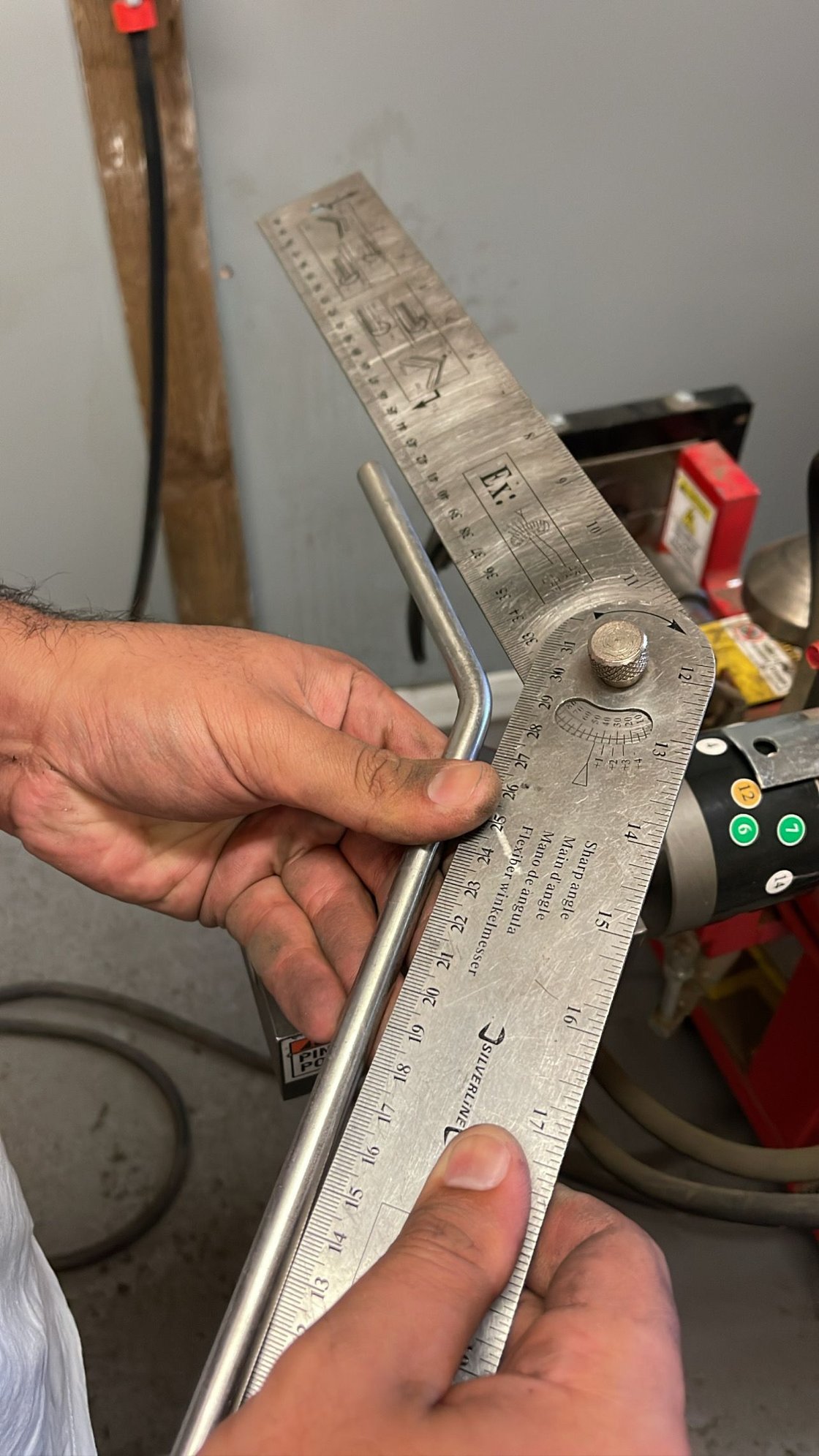

I started by Removing the engine undertray and side under trays and you can see the grommet and cover to remove, locate to the tool in the correct position and you will feel the tension when you get to where you need to be, few big hits with the hammer till the tool goes all the way in and the job is done. Took me around a hour Inc making the tool etc.
if anyone needs the English TPI I have it you can contact me and I will send it to you, if you need the tool and you are in the UK I can lend it to you, it’s the exact size etc to the Audi tpi and is in solid 10mm stainless steel so works well, if you are close to London I can help you do the job.
Thanks to you all and good luck to anyone attempting it I hope it solves your issues too !

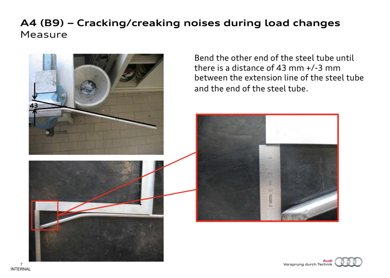

One last comment, the TPI states you need to measure the edge to the end bla bla bla 43mm length etc, both me and @newcastle64 made the tool so it is 43 degrees at the bend as opposed to the Audi way as you can see in my pictures above, this is the correct angle as it has worked seem-lessly for both of us. Thank you again @newcastle64 and the other gents in this thread for your help I can now enjoy my A4 like the big sexy comfy cruiser / daily it is ! 🤣

@Ozy thanks for the detailed post!
I see you've removed the cover on both sides.. you hammered both sides?

@Void20 yes mate I removed the cover on both sides as I was getting very very loud noise and feedback from the footwell, mine sounded like a bag of spanner’s, I used the same tool for both sides and it was one of the fastest things I’ve ever done 🤣
