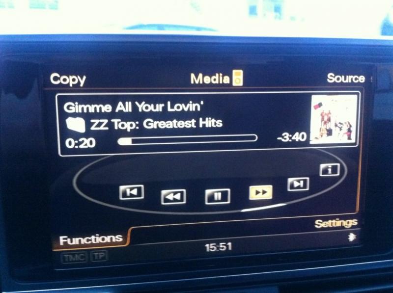

Ok, so I just got back from my dealer, and my ipod sofware is now updated. My red cable now works. Also, my car is an very early car, an 2011 model.
The attached images show the old version; HN+_DAB_K0097 (I've got an euro spec car), the new version HN+R_EU_AU_K0485_18, and a (bad) picture of the working red cable in action, and a picture of both cables.
The update came in the form of an CD, and the dealer updated it. It took a little while, a few hours.

Some additional info on the software update; It will also update the bluetooth, so that it uses 6 digit keys to connect instead of 4. Which means you have to bond all your devices again after the update. I could'nt do it right away, I thought the thing was broken, because the car was not detectable. But I figured I give it a day, and the next day everything worked nicely.
Also, when playing video, the sound does not go over the audio system. I think I read the same on another thread too. It's a bummer.
