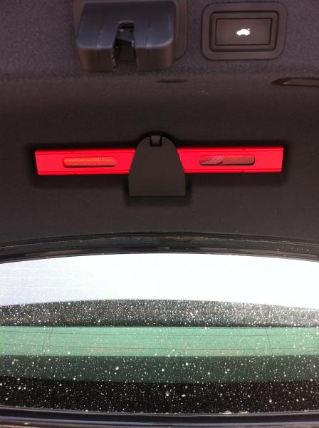

Originally Posted by darcivic00si
I ordered the triangle and holder from my local dealer here in the UK. Thanks for posting the pics!
I plan to install it next week. Any tips on removing the liner? You had to drill holes into the actual trunk for the two push clips? What length of screws did you use?
The trunk liner can be pulled off after removing the 2 screws in the pastic handle to close the lid and the 1 screw in the inside trunk opener. The black plastic cover of the hinges can stay on.
I use 2 5mm screws and drilled a 2mm hole right next to the square area where the clips are supposed to snap in. There is about 7mm between the outer skin and the inside frame. your dealer may be willing to show you how the trunk liner needs to be cut out so that you don't have to use screws. That's definitely the better option.

Originally Posted by shaikhasm
my car came with a safety triangle and i'll take a photo when i have a chance and post it
here is the OEM triange
sorry for taking too long cuz i didn't have a chance earlier
