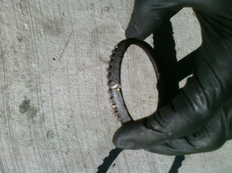

Default UPDATE!!! IVE FOUND THE SOLUTION!
UPDATE!!!!! Yes I know it's been months and months. But I've found the solution to the random relay clicking, Xenon headlights flickering, and lastly the famous rear brake random lock up!... Yes I've found it.
Turns out after long tests and many many nights of scratching the head at why the rear brakes kick on and headlights flicker due to some relay clicking when the brake pedal is released or throttle is feathered on the fwy. The culprit you ask, well that's the good ol' wheel bearing. And now you ask well what the hell does a stupid wheel bearing have to do with the brakes or even the damn headlights!
Well... EVERYTHING! That is when the wheel bearing begins to fail, what does it do? It begins to allow the axle to travel up, down, pretty much in every direction. And what does this do in turn to our equipment?? well that little abs ring inside that hub starts to rub against the inside of the CV housing (hub). When this happens it causes the ring to get chewed up and literally grind itself down. To the point that the wheel speed sensor can't always pick up the correct reading, thus falsely activating the rear brakes only and prematurely. I also tested how it reacts to the steering wheel due to the clock spring with angle sensor, it actually increases the chances of "brake stab", which is activation of brakes abruptly.
Now many of you are probably saying, well that's not true cuz vag-com says my wheel sensors read correctly all the time... Well.. YOUR WRONG! sorry... well no I'm not. But your still wrong very much so. And why, simple because my system I have in my car, I can read my wheels speed directly on my dis, and all my wheels say the same... speeds are match and are good. Now your gonna say well my ring was cracked... well no it isn't. My ring had just enough finger depth to read and work correctly most of the time. I'll post a picture of it... it's 3/4 worn down... yet still worked, oh also my sensor has been chewed up by the ring due to the bad wheel bearing. So all in all, my read outs all read correct. even tho I knew i had a bad ring. Either way I still had the problems constantly.
So the solution, many of you already know. Buy a new CV.... well once again we're right back to.. YOUR WRONG. I say it out of love. does that help? Anyways, I know I know... all of you are saying wtf!... well in fact buying a new cv to get a new ring is in fact mostly the only way to repair a "bad" ring. But not anymore...
No need to spend 85,95,100 dollars in new cv's or even axles as some of you had done that. I've got many of these rings and if anyone needs to replace one or more, then let me know.
The solution to getting your lights,brake system and random relay clicking. Is to replace that bad wheel bearing and the abs ring thats bad on that side. Then the all the systems will go back to normal. I've been click free, flicker free, and brake stab free for almost a week now... AND DAMN DOES IT FEEL FREAKIN NICE!!!!!!!
Send me a PM if ya need the replacement rings. Mind you, you wont find them anywhere... Germany sells them at $125 (75 euro) a piece (that's way to expensive, get them from me, much cheaper). And no one else anywhere has them. Trust me
