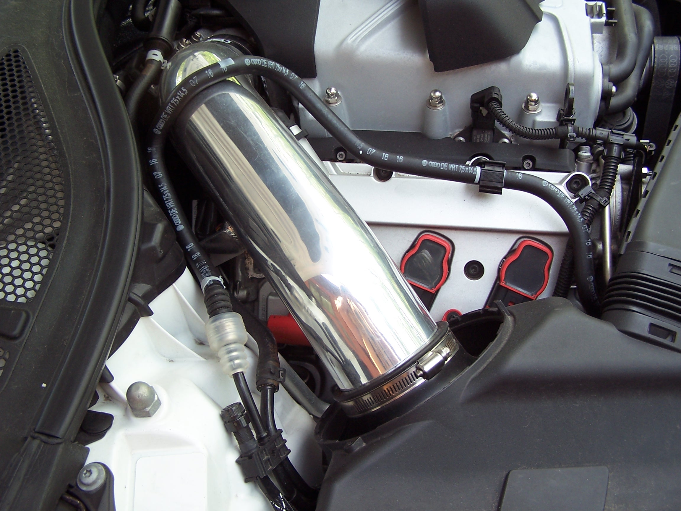

For those that have the intake upgraded, do you just leave the 2 breather hoses hanging like that? Wouldn't that cause any rattle of some sort?
I haven't heard any rattles from the hoses. One is the fuel line to the high-pressure pump that was replaced and the other appears to be a return to the tank.
Mine looks just like that also. No rattles I've heard. Just the sweet whine of the supercharger.

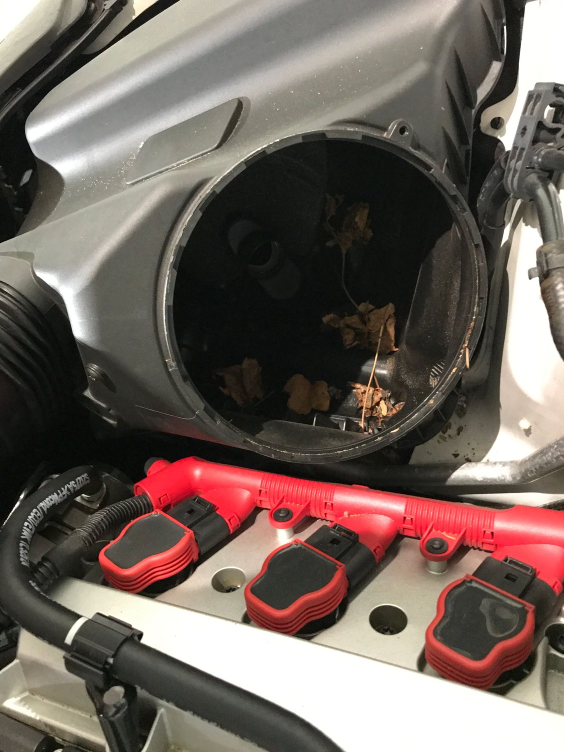

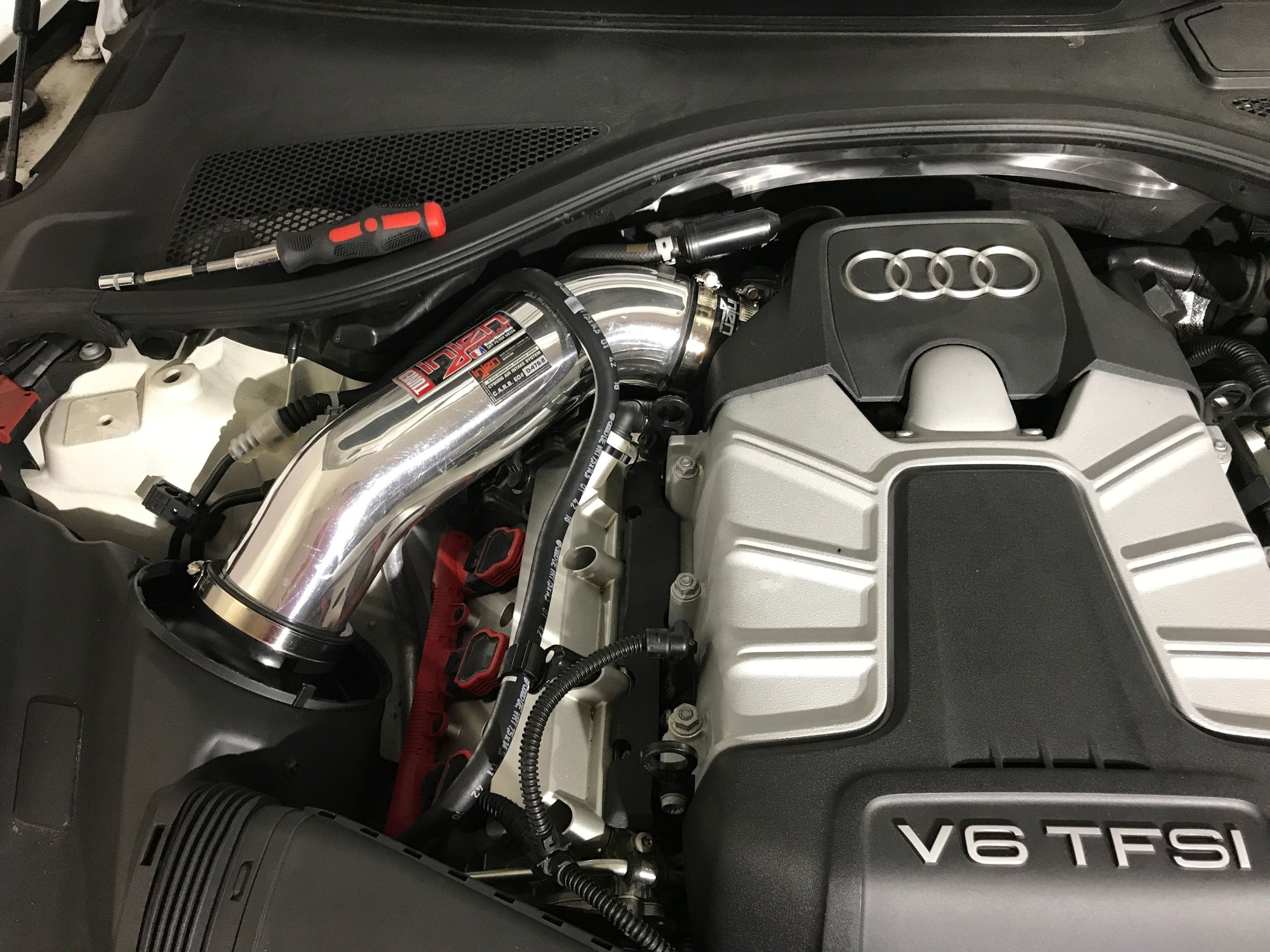

Just installed the intake. Car has only about 29000 miles and the filter was filthy. Just look at how much debris there was inside the box. Another thing to point out is that the bracket orientation is completely wrong. I did not use the bracket as it will not allow flush fitting of the rubber hose at the throttle body end. See the photo above that shows how far the bracket is from the body of the car (I didn't take the photo of the enclosed rubber bushing adapter on the car). Anyway, with everything all tightened down, there isn't any movement from the intake at all.
