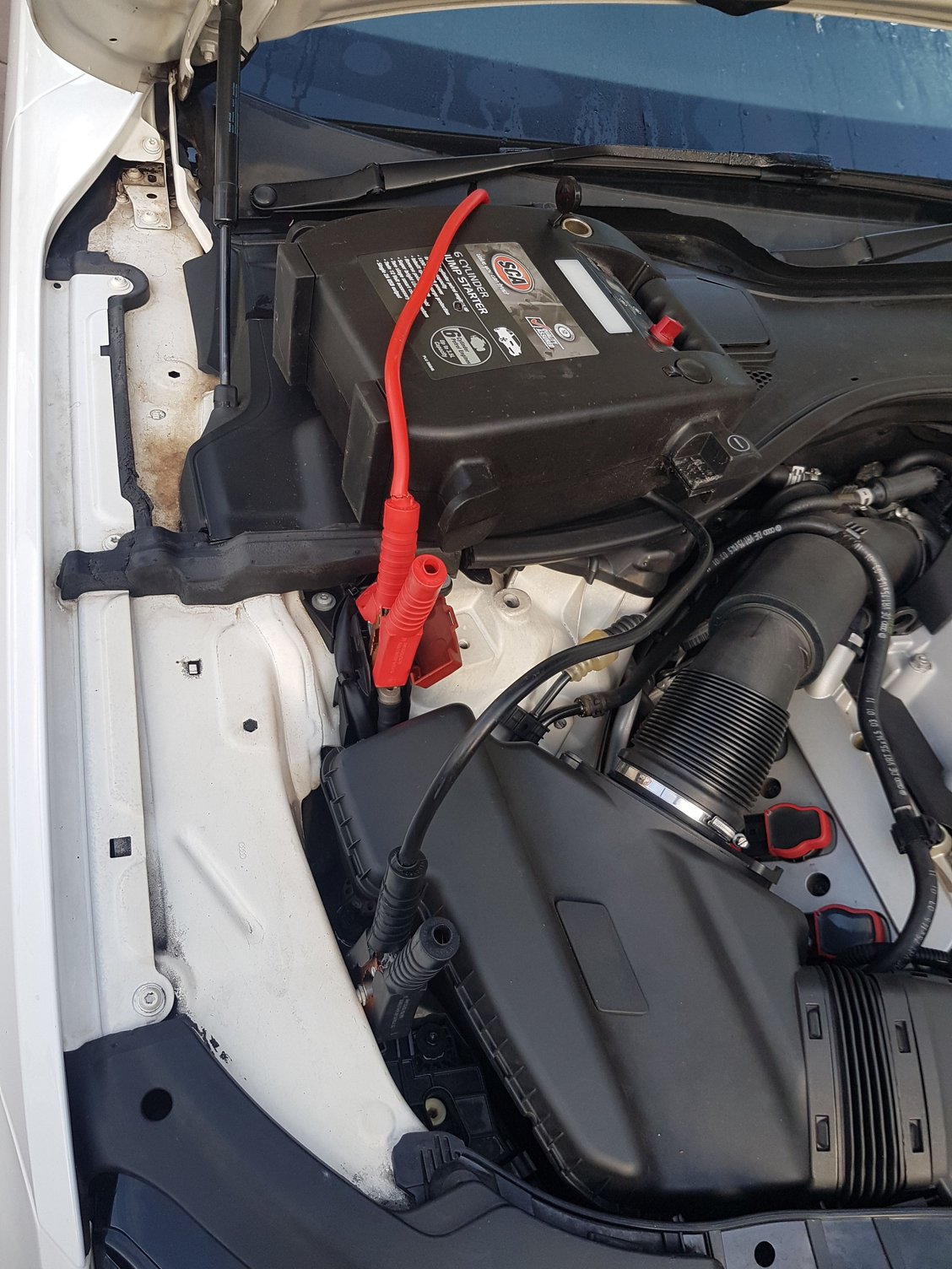

So... as a refresher every morning when I started the Audi the rear spoiler fault would come up.... I would drive it around and the fault would go away.... the next morning? after the car had been sitting overnight the fault would return...
Not wanting to spend $500 on a new battery if I didn't need to ( the Audi Specialist wasn't sure it was a battery.... he when had enquired about a motor for the spoiler)..I thought of a way that might test it.
I thought maybe if I attached a Battery Jump starter pack in the morning before I start the car- it should compensate for the voltage the battery might have lost overnight if faulty. So this morning I did this.....
Connected it ( as per photos) and started the car - no rear spoiler fault.... I will try it again later, but this is the first morning in 2 weeks of starting that no fault has been recorded.... looks like a new battery required!!
Thanks everyone for your help and guidance
