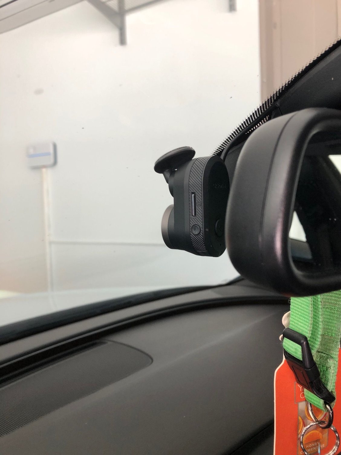

The camera is hidden behind the mirror, I don't see it while I'm driving
It was extremely easy to dress the cable. I didn't have to remove the pillar cover, since I just pried little on the seams to tuck the wire. Then I hid the wire in the door gasket.

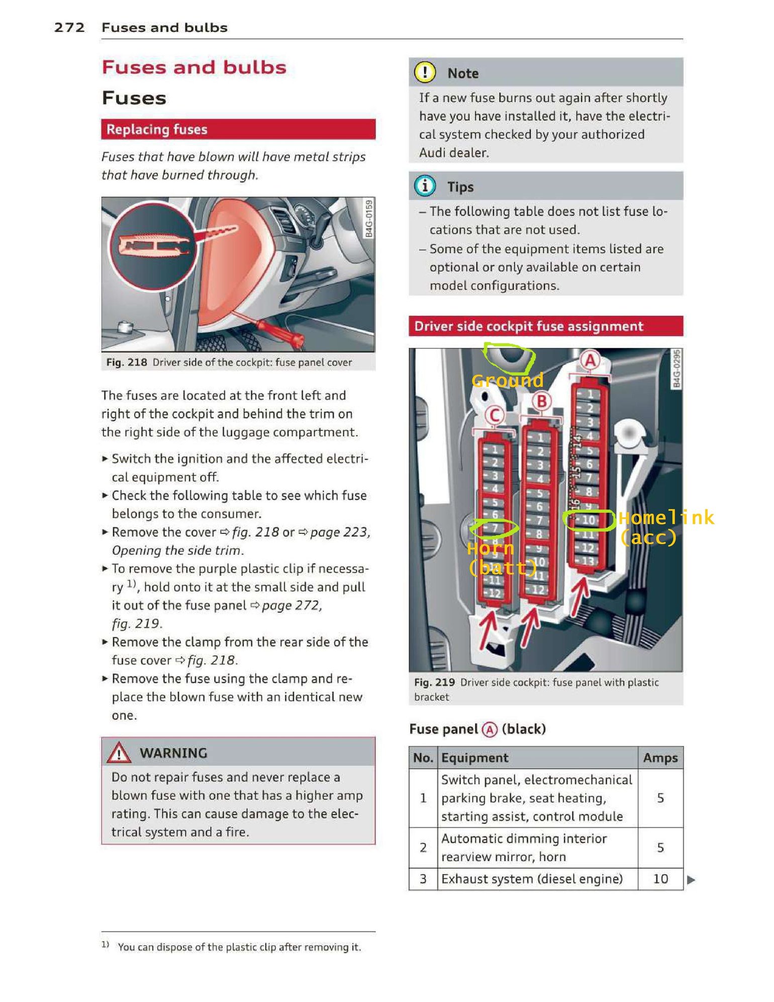

The parking mode cable has three wires - Ground - Battery - Accessory.
These are the fuses I tapped into.

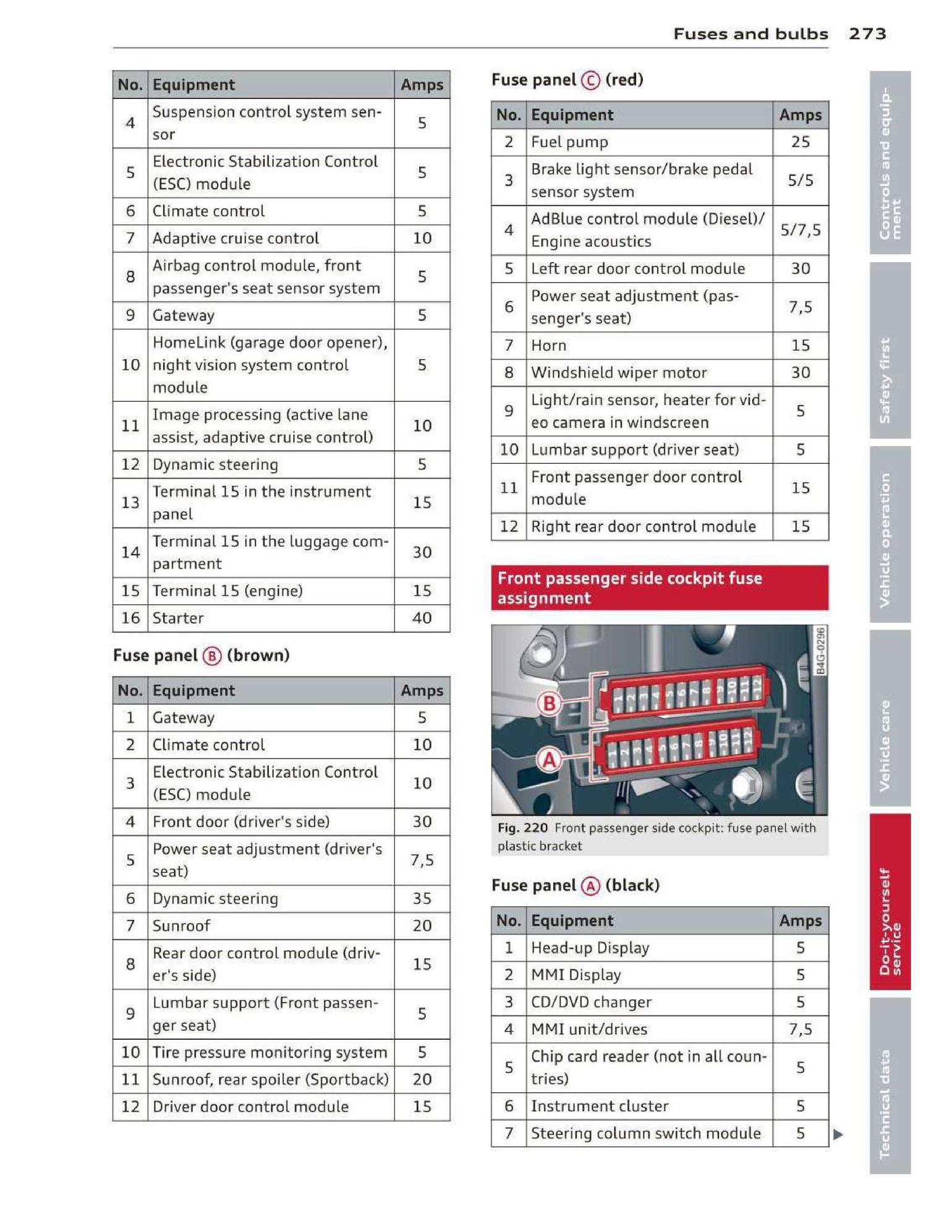

The Homelink (#10) fuse from column A (mini fuse) for the ACC wire (the manual says it is a 5amp fuse but it is 7.5amp in my car... go figure)
The Horn (#7) Fuse in column C (Standard fuse) for the Battery wire
And the bolt for the ground wire.
Here some pictures when I finished:
Remember to use a lower amp fuse for the wire you are tapping (5 amp after the 7.5amp homelink fuse)
Here I used a 7.5amp after the 15amp Horn Fuse
