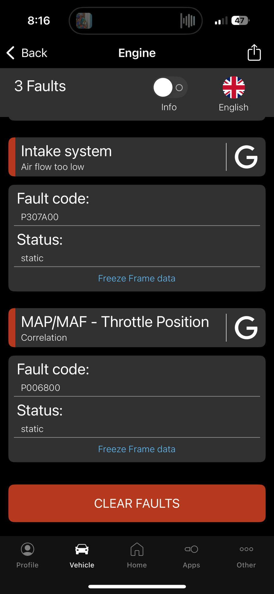

Got two codes after an obd11 scan but no check engine

I’m assuming I just need to replace the air filter or map sensor but any further clarification would be nice thanks!

I would start with replace air filter and use Brake Clean on a rag to clean the interior of the throttle body around the metal flap.
