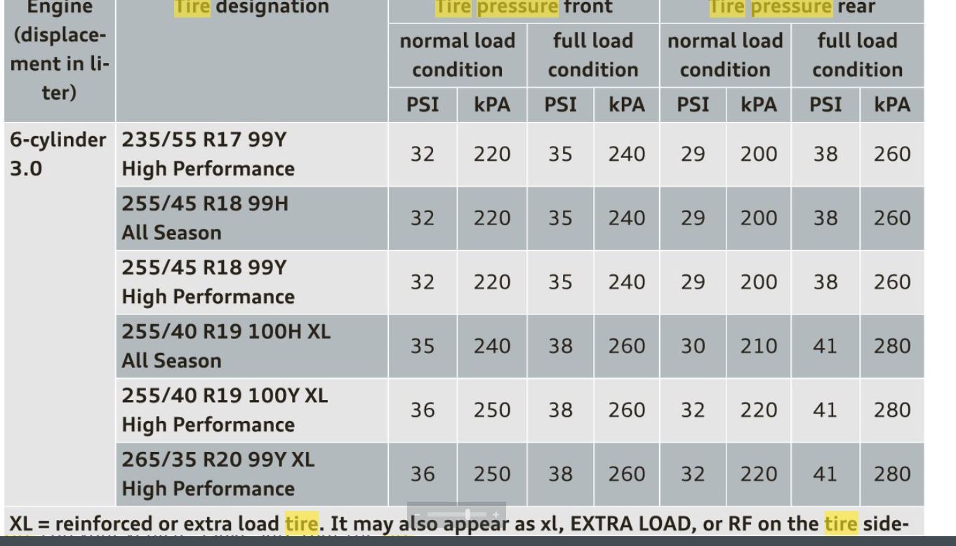

Cody, if you open the Owner's Manual for the car you will see the various tire/wheel sizes that work.
As long as all 4 tires are the same size, you're fine.
225/45/18 is not the correct 18" tire for the car. Too small, inadequate capacity, etc.
There are no TPMS sensors in the wheels.
Welcome aboard!

Default anything from 17" up to 20" was OE equipment
