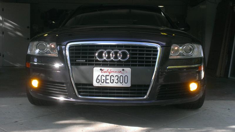

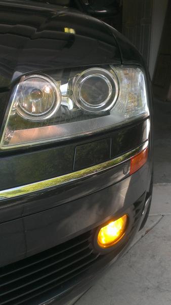

Default I went yellow fogs as DRLs
Originally Posted by dvs_dave
Good tips. Xenon match or yellow? Yellow might look a bit odd for DRLs though? Also looks very 1970's French.
Maybe its just me, but I think the yellow fogs are looking pretty good. I wasn't sure at first but now I like them. If I tier of them, I'll go back to my Hoen Xenonmatch "white" bulbs. As they are an easy change.
My logic on the yellow is this is a sporty European luxo sedan that can pull off the GT look of yellow front facing DRLs. All the late model Corvettes and Caddys in GMs line are running amber DRLs and tend to stand out just a bit on the highway. So i thought I would try it as well.
The lights are more yellow than the photo shows...
