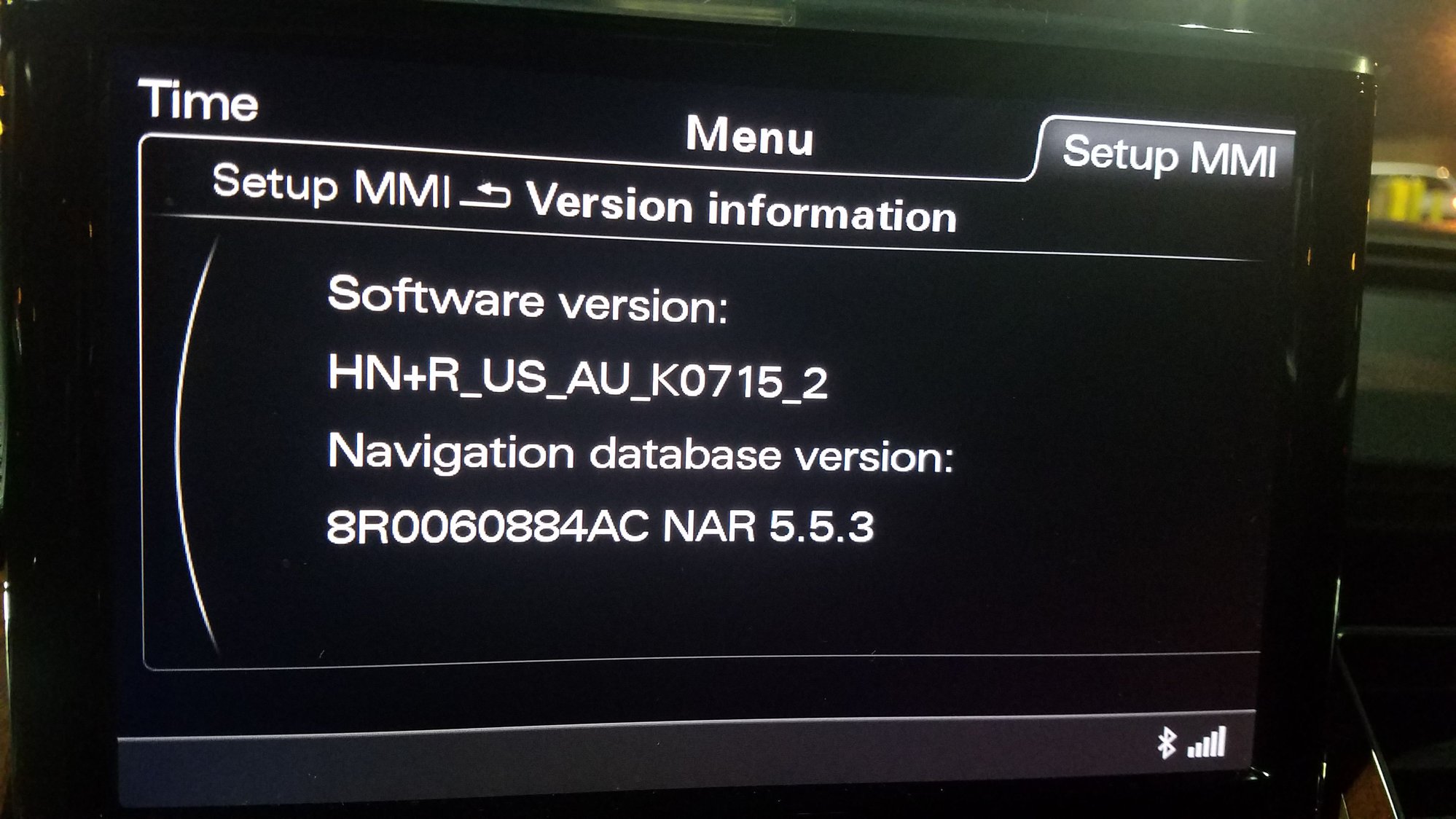

Just picked my car up from its 35k service and I told the service advisor about the speaker distortion when I dropped it off... There was a TSB and they updated the Bluetooth firmware. TSB 2033032/2 and TSB 2030465/10 is what it says on the repair order. Haven't had any distortion yet, but I've only placed one call and had the car in my possession for 1 hour.
This is my version i believe its lower then yours, could you play around with it and give us an update to confirm if its a software fix or if need new speaker

Software Update didn't fix it... it sounds like the center speaker is where phone calls come out... so I'll have them check that next time I take it in.
