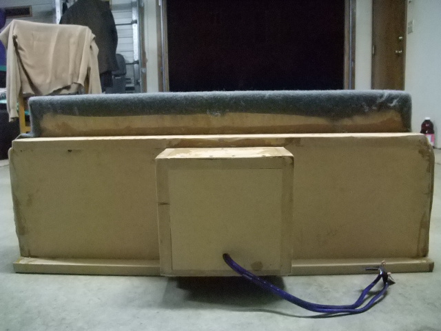

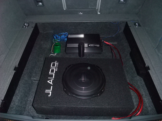

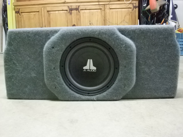

The first thing I installed was an ARC audio 2 two channel amp rated at 100 watts per channel. I, initially, ran it to a Fosgate 12 I had in a previous car. To my surprise everything worked. It was great to hear actual bass coming from the back of the car. About a day later, I decided why not throw the sub I had in my RL, and hear how it sounds compared to the Fosgate. This is a JL 10 with an enclosure custom built to fit in the trunk of the RL. This sub sounded awesome! It, actually, sounded much better in the Q5. Even though it sounded great, I knew it wasn’t going to be a long term solution, since it was very bulky, and wasn’t designed to fit the Q5.

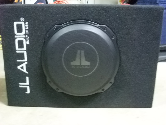

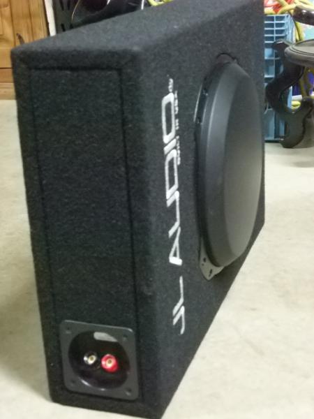

With that in mind, I started researching subwoofers that would be a better fit for the car. After a week of looking at options, I honed in on the JL 10W3. This is a shallow mount subwoofer designed to fit in a small enclosure. This is a brand new product from JL just being shipped out to their retailers. I could only find two shops in the greater Sacramento area that had the subwoofer in stock. To my surprise, and the owner who just came back from vacation, they had the speaker + it was housed in the enclosure designed by JL. After looking at my amp install, the Owner allowed me to audition this speaker as well as the ported JL 8 box, and the Kenwood 10 box in the back of my car. The Kenwood was okay. The JL 8 was more efficient, but the JL 10W3 sounded warmer, and had a more low end kick. It was comparable to the JL 10 that came out of my RL. I bought the sub which retails for $299. With the box, JL only increases the price to $349.
On the way home I had a chance to listen to it under normal driving conditions. I was, actually, disappointed in the overall sound, and really thought I made a mistake. When I got home, I disconnected it, and plugged in the JL 10 from my RL. As confirmed, the old JL sub hit much much harder than the new one. I remembered the stereo shop recommened I check the gain on my line output converter (the green unit next to the amp) as he thought it may be turned down. This did the trick. The new 10 came to freakin life! I tested it again with my old JL sub. It not only matched its sound, it didn’t distort during a tough part of a song where the old one did.

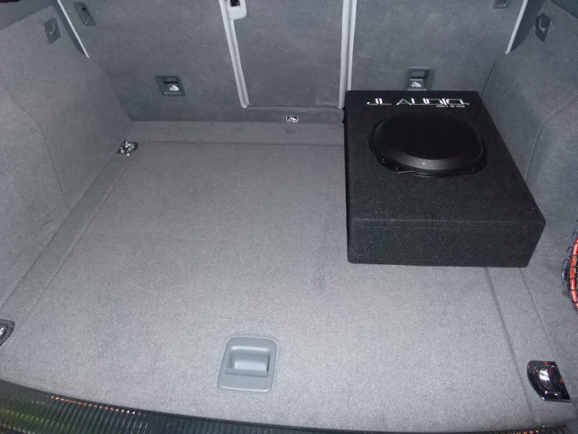

As you can see from the pics, the JLW3 takes up very little space, and provides a couple of mounting options. It fits perfectly under the cargo area where the removable tray is located. However, if you install in this area, the spare tire will not fit.
Next for me will be to install a smaller amp I have on order which will, most likely, be installed under the driver seat. Then, I can run the sub stealth, or if I’m taking a long trip, have it in the cargo area, and put the spare tire back where it belongs.

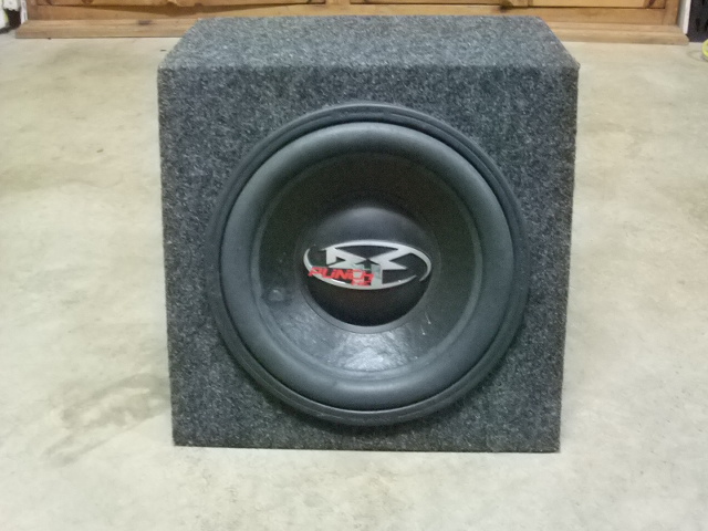

Default More Pics
Pics of the other two subs I tested in my car plus the JL10W3 I purchased.
