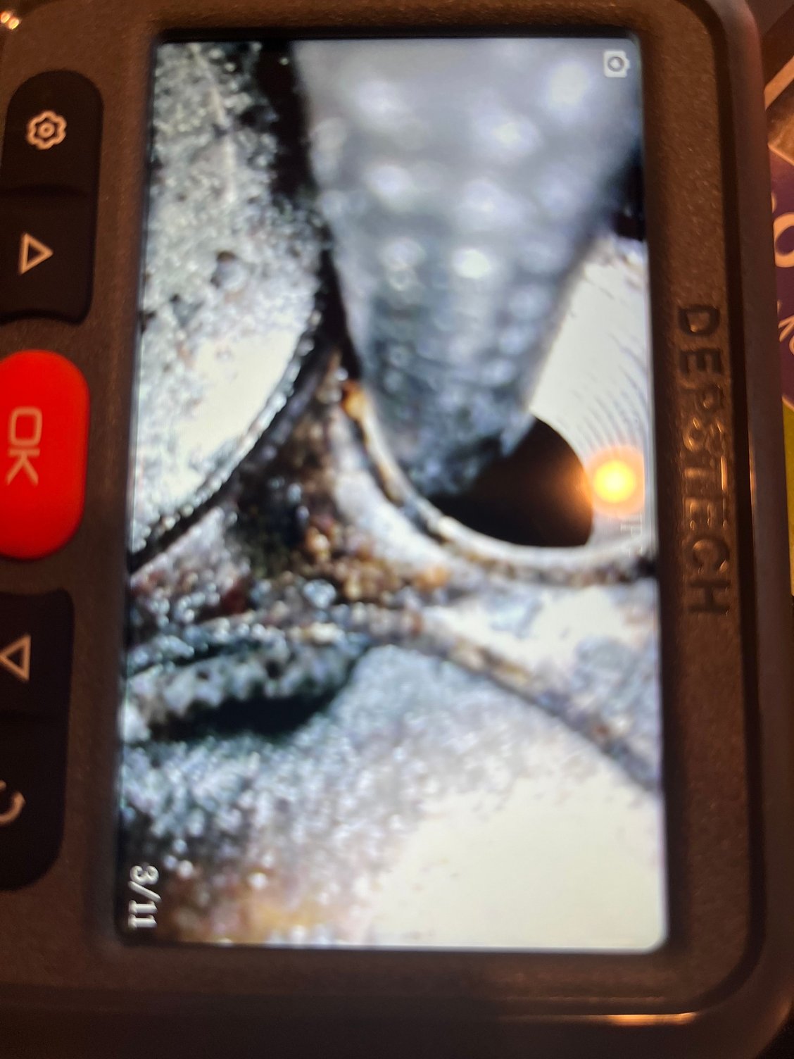

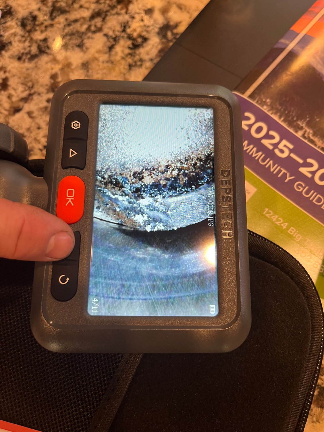

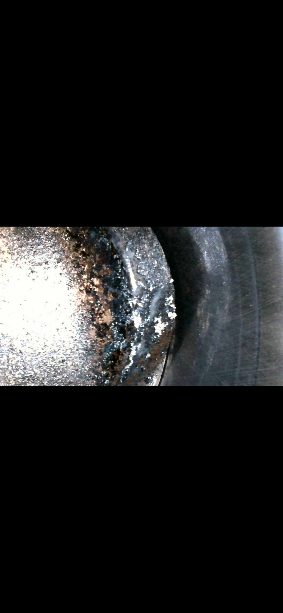

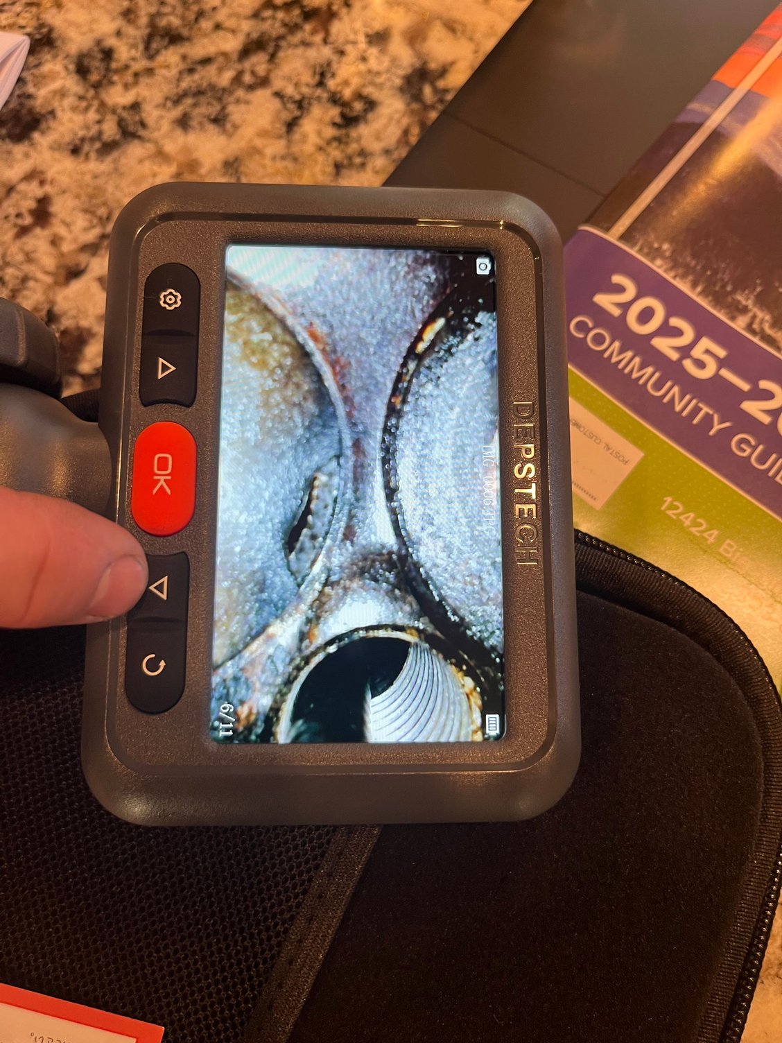

Default borescope visual. 107000. Audi 3.0 issues.
closer look at piston.
burned broken exhaust valve
piston piece missing ring visable.
same look at exhaust. 3 cylinder.
Light tension piston rings and direct injection issues along w long interval oil changes has caused many issues.
Engine toast here.
I have another 2017 w 106000 on it. Trying engine oil flush. bg44k clean up of injectors and 2 oil changes of 5w30 valvoline Restore and protect at 5000 miles. Then switch back to Motul 0w40 clean oil. Dont buy the lie. These 3.0 have REAL issues.
