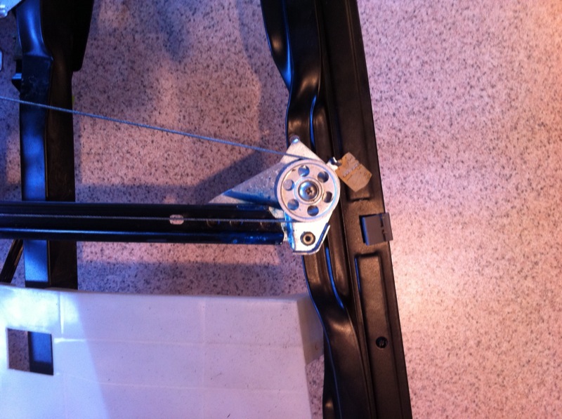

Leaving the house with the family for a day out in our "spare" 99 A4, the LR window crapped out pulling out of the drive... We switched to the "Trusty" Touareg, and when I got home I saw this post (thanks). It was Sunday, and didn't want to wait forever for parts, so tore it apart. All the parts seemed good except a broken pulley. The pulley hub is not removable, so I ground it off, drilled and tapped it and found a hard anodized aluminum pulley with precision bearings from an old telescope I had laying around , threw it on the lathe and made it a single row pulley (was double row). That and a stainless steel screw and I was in business! (dang that cable tension is high!) Cost = 0.
Aww, I would've done that if I had a lathe and a hard anodized aluminum pulley with precision bearings from an old telescope too. Good work and I'm glad my post helped to inspire you. These cars are getting old enough that we need more posts on riggin up something that works rather than just replacing the factory parts. Thanks.
lol.... I could probably make the whole car if I had the time and patience, but your post got me to dig into fixing it instead of just ordering parts and doing it a week later
