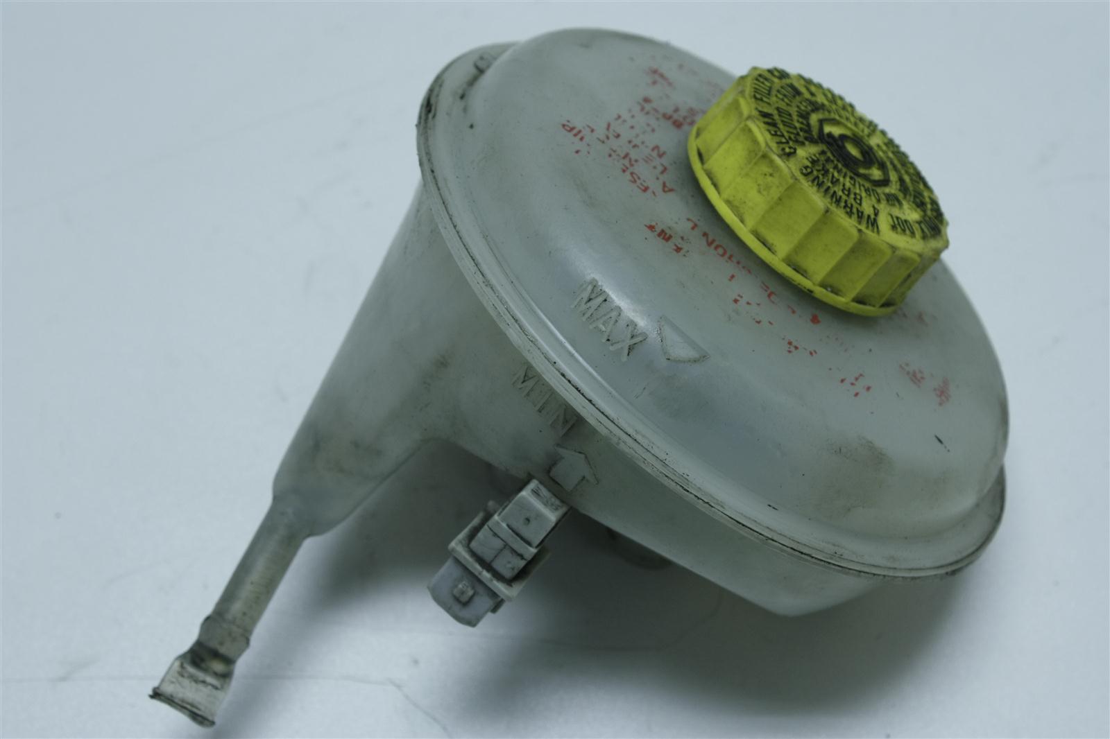

Well i'm digging out this old thread to ask my question.
I have a crack on the brake fluid reservoir and was about to order a new one when i noticed that there are 2 different shapes. Many reservoirs have this long tube/nipple on one side picture link picture link 2 but my oem one doesn't have it. Why is this tube there and are they interchangeable without any modifications?
Old 01-13-2015, 10:37 PM
ert
ert's Avatar
Join Date: Oct 2014
Posts: 4
More pics to show the difference, what i noticed is that vagcat part code for my car should be 8D0611301, but the one with this nipple has 8E0611301 yet the parts catalogs offer the "E" one for my car and not "D".
E
http://www.auditeile-wolf.de/Bilderi...ehaelter-2.JPG
http://img.ptimg.com/is/image/Autos/repa161302_is
D
http://farm6.staticflickr.com/5488/1...3845a859_b.jpg
http://www.partsbase.org/media/image...1d0eee08da.png (except for the sensor)
I'm guessing this nipple is for cars with ESP or some sort of other electronic aid?
