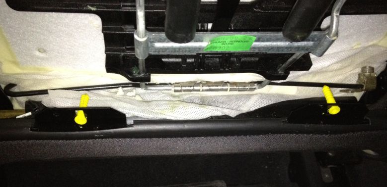

Thanks to LINEa... & ghalcomb for the 'How To'. The clips on the driver's seat back in my 2002 A4 broke a few days ago. I just got finished with the 'inexpensive' repair & am attaching a pic.
While inspecting the interior of the seat, I noticed that one of the Lumbar Support rods had broken. I found a large screw-on electrical connector in my 'junk' box that was just perfect to reconnect the broken rod ends. See pics.
