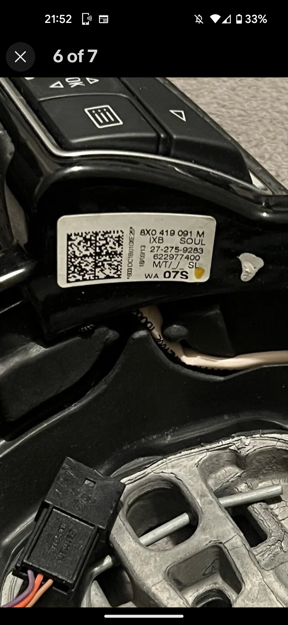

Hi guys I currently own a A7 2011 3.0TDI SE with the four spoke steering wheel. I'm looking to change this out for a 3 spoke steering wheel however confused. Most steering wheels come without airbags so I'm trying to ensure 1. That they fit A7 plug and play 2. Airbag is compatible with steering wheel.
Current OEM factory steering wheel
I have found these - steering wheel and airbag can anyone confirm they will fit my car?
Buttons are same layout etc as 4 spoke factory wheel

yes, if they are off another A7 or A6 C7/ C7.5 they will fit.
however if they are off a different car like an A1
or A3, then you would need to reconfigure the wiring on the airbags.
but why would you get the old units that look dated anyway?
