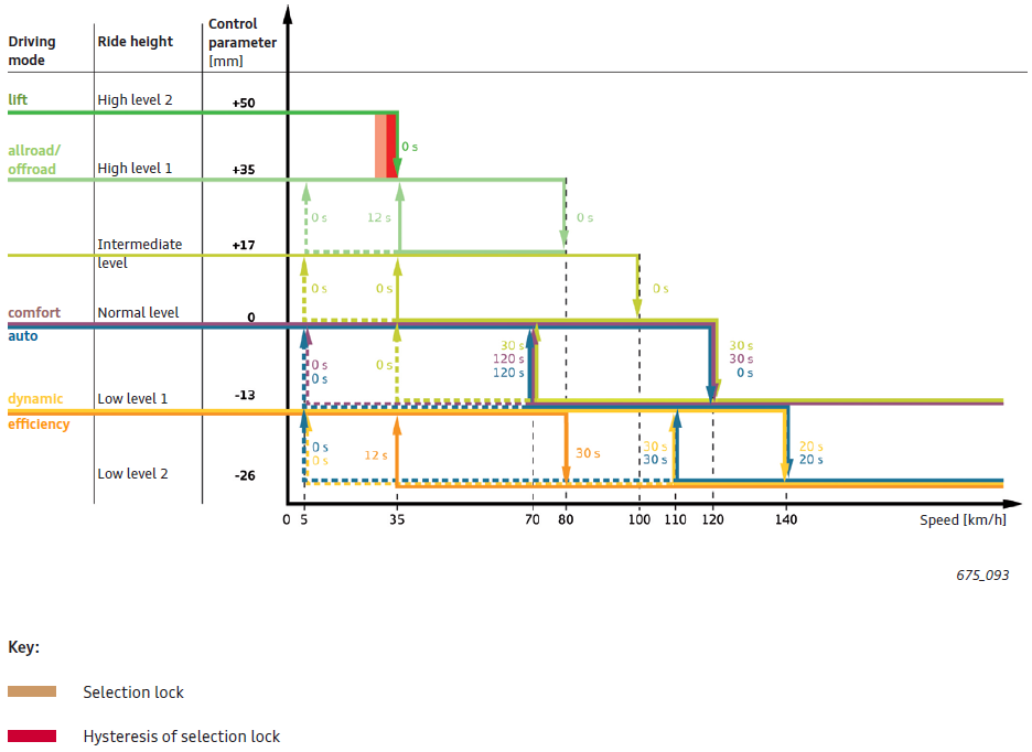

The automatic level change at higher speeds has always been there, with no override option by default. So the question is rather why your car has not done the auto-lowering before. I suspect it could happen if someone did any manual adaption coding to the control module. There is e.g. a "showroom mode" that will keep it fixed at a (high ?) level, but that is not intended for driving (for efficiency, but also stability). Have you had the car since new?
Here is anyhow the regulation plan (from self study programme 675, aka SSP675) . I suspect what you observe is the mandatory drop (in all drive modes) from "Intermediate level" to "Normal level" at 100 km/h (~60 mph). The various seconds given for the transition arrows is how long the speed must be observed before a level change happens. E.g. in auto mode, the speed must exceed more than 140 km/h for more than 20 seconds before the suspension goes to the lowest level. Arrows with "0 s" implies that the level change happens without any such wait time.

Are you using the same drive mode as before? Auto/dynamic will lift as speed drops below 110 km/h (68 mph). Efficiency will lift at 35 km/h (22 mph) while the other modes lift at 70 km/h (43 mph). All of these are again dependent that you had sufficient freeway speed to lower the car in the first place, between 80-140 km/h depending on drive mode (see graph in previous post).
You can check what level the car has by keeping the drive select menu open (lower right corner). It will also show a small animation there when changing levels.

Then the car should raise from "low 2" to "low 1" once you have been below 35 km/h (22 mph) for more than 12 seconds (assuming you had more than 50 mph on the freeway).
