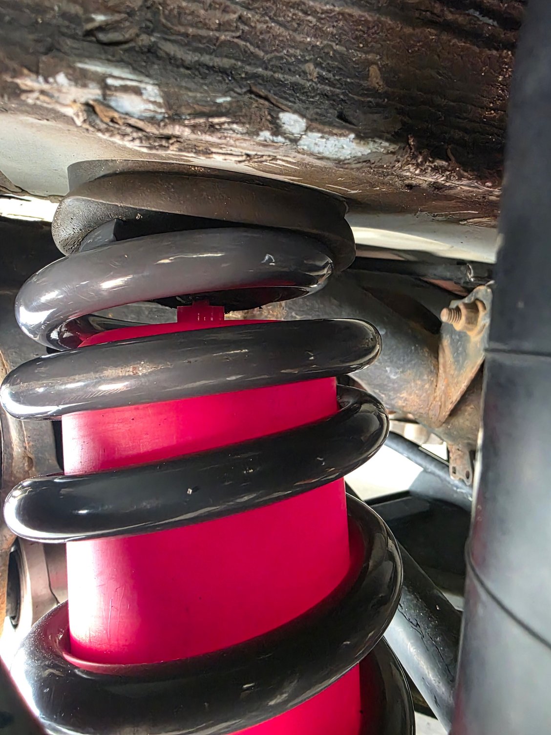

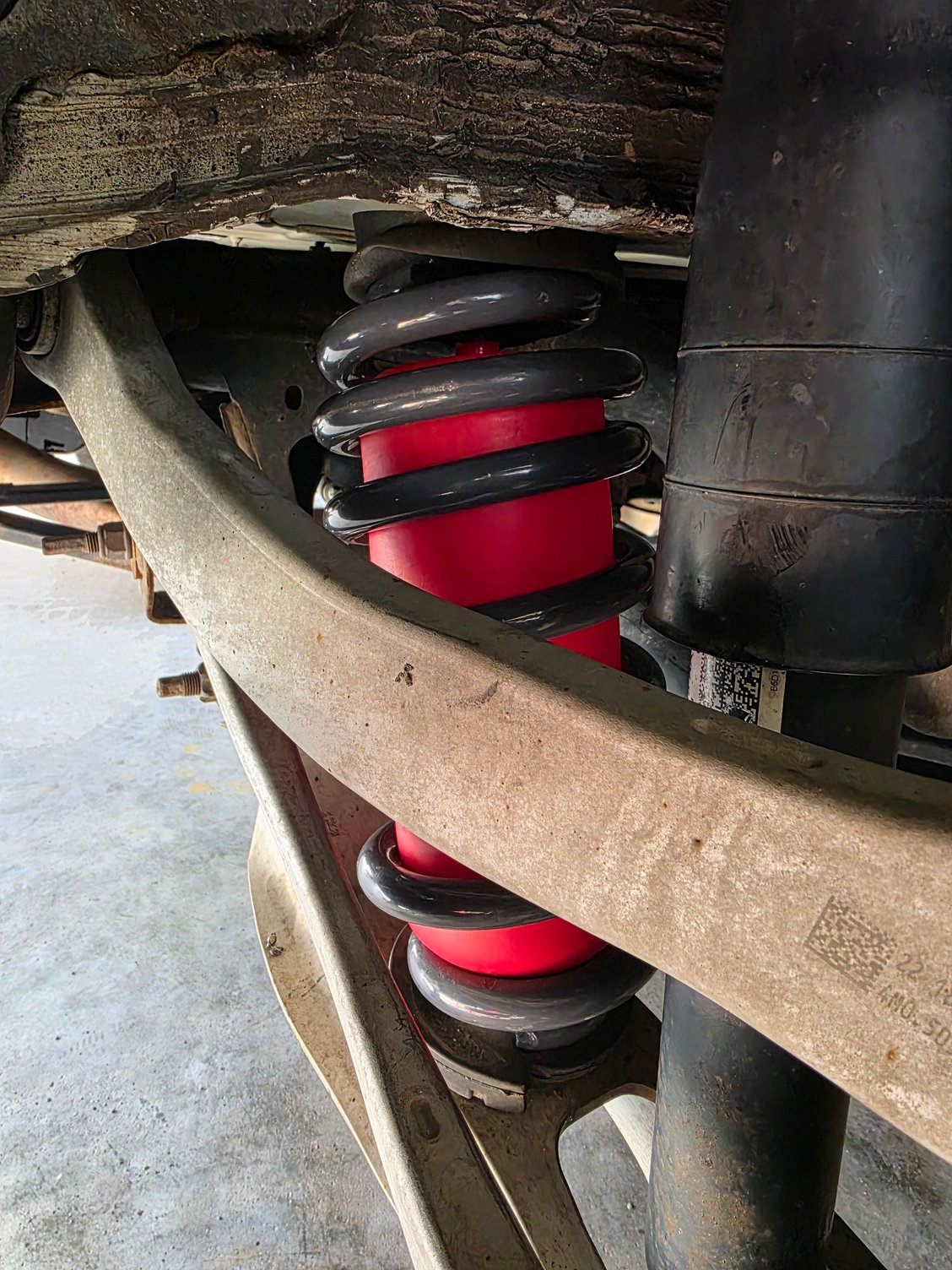

I don't tow very often but after the sag issues towing my M3 last year, and me getting the dynamic + springs this year. I got the 60905 kit and installed it for my upcoming trip. It was a royal bitch, I actually ended up removing the springs, and used a jack handle to actually push it through, with a lot of words of encouragement.
I cut the nipple off the top insulator, and space wise it's basically spot on.
Routed the lines to come just out of the plastic guards
Pumped up to 6psi when not in use, but oh my are they effing noisy as hell. I just hear the constant rubbing ,could be the low pressure but they're definitely getting cut out after my trip, as I don't need them through pretty much the entire year and removing them without cutting is probably going to be close to impossible

Interesting. I believe I installed the 60900 kit. I was able to do it without disassembling anything, but I did trim off the sharp point on the upper spring mount. I also installed the circular spacers on the top and bottom. I don't get any rubbing sounds either when inflated or not. I think the 60905 are wider and much taller, which makes sense that you struggled to install them. My kit works, but it could be better and I suspect the sizing makes a difference.
60900 - 3" x 5.5"
60905 - 3.44" x 8.75"

It could be specific to the 034 springs too as I believe everyone that posted here is on factory springs.
But they are definitely tight in the spring. They can move up and down so they're not "stuck" but you need to push them down, in order to get them to move.
With these springs the 60905 kit fit perfectly height wise, there is actually not much room for a spacer, even their thin one.
I did buy the 60904 kit too but it was a lot shorter, same width basically, so I opted to do the 60905.
If I was doing this on the regular, I'd definitely be looking into another kit. Removing these in one piece will be close to impossible, sucks but it is what it is. Hoping tell at least do what I need them to for my trip
